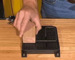

Well as you know I have not invested in a vacuum system yet, but plan to.
Anyway I was at a friend of mines cabinet shop the other night and he had these V-clamp all over his shop
The work using your compressed air through a venture port on the clamp and a rubber gasket. My friend loves them. He gave me on to play with. I got back to my shop hooked it up and tried it out as a holder while routing channels for binding with my luthierstool.com binding jig. Man this is perfect. I tried it for several tasks. It worked like a charm, so I ordered 2 clamps and2 on-off valves You can get the clamps single sided or double sides and tall gaskets for radius parts, but the standard gasket works fine with 15' radius backs. They hold good and tight in any position horz, vert, or upside down. The need 80psi-100psi air supply at 2cfm to work continiously

just checked out the website...i guess the venturi is located right in the jig?
If you want to generate vacuum using compressed air, just do a search for "vacuum generator". You should be able to find some similar venturi systems which you could route to your own jig.

I have a small vac pump and a venturi. I find the venturi pulls a better vacuum, much higher CFM at full vac, but it uses a lot of air and is noisier so I use the electric pump when I can get away with it.
If you don't have a pretty hefty compressor sitting around and don't need enough suck to stop a guitar neck from flying off your CNC, then the electric pumps are a great deal.
I do find it funny how expensive the venturis are considering how little stuff there is inside there, though...

Looks like those guys only make clamps with built-in Venturis. There are a bunch of companies making vacuum clamps for general use (Google). If you want to roll your own (ie: drill a hole, apply weatherstripping, profit!) then check out http://www.joewoodworker.com/veneering/vacuumclamping.htm
